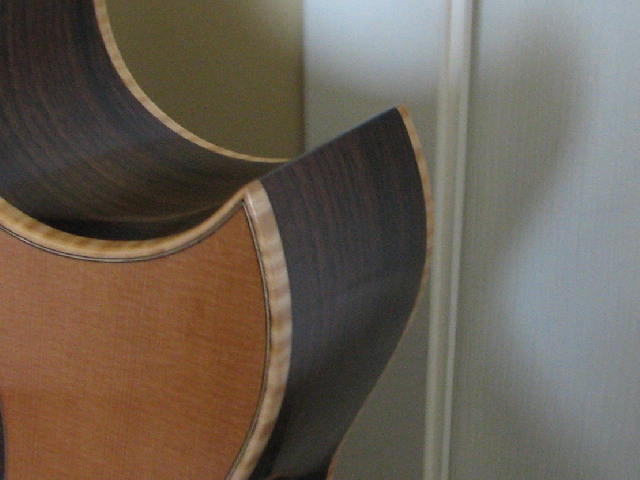

Hey Ron, I think that a Redwood top would give you what your looking for.
Than I would use the curly maple bindings you have to contrast the rest of the dark body.
I like light on dark
Rod True39097.0560069444

[QUOTE=Rod True] Hey Ron, I think that a Redwood top would give you what your looking for.
Thanks, Rod,   that picture helps a lot.   The maple trim looks great.
